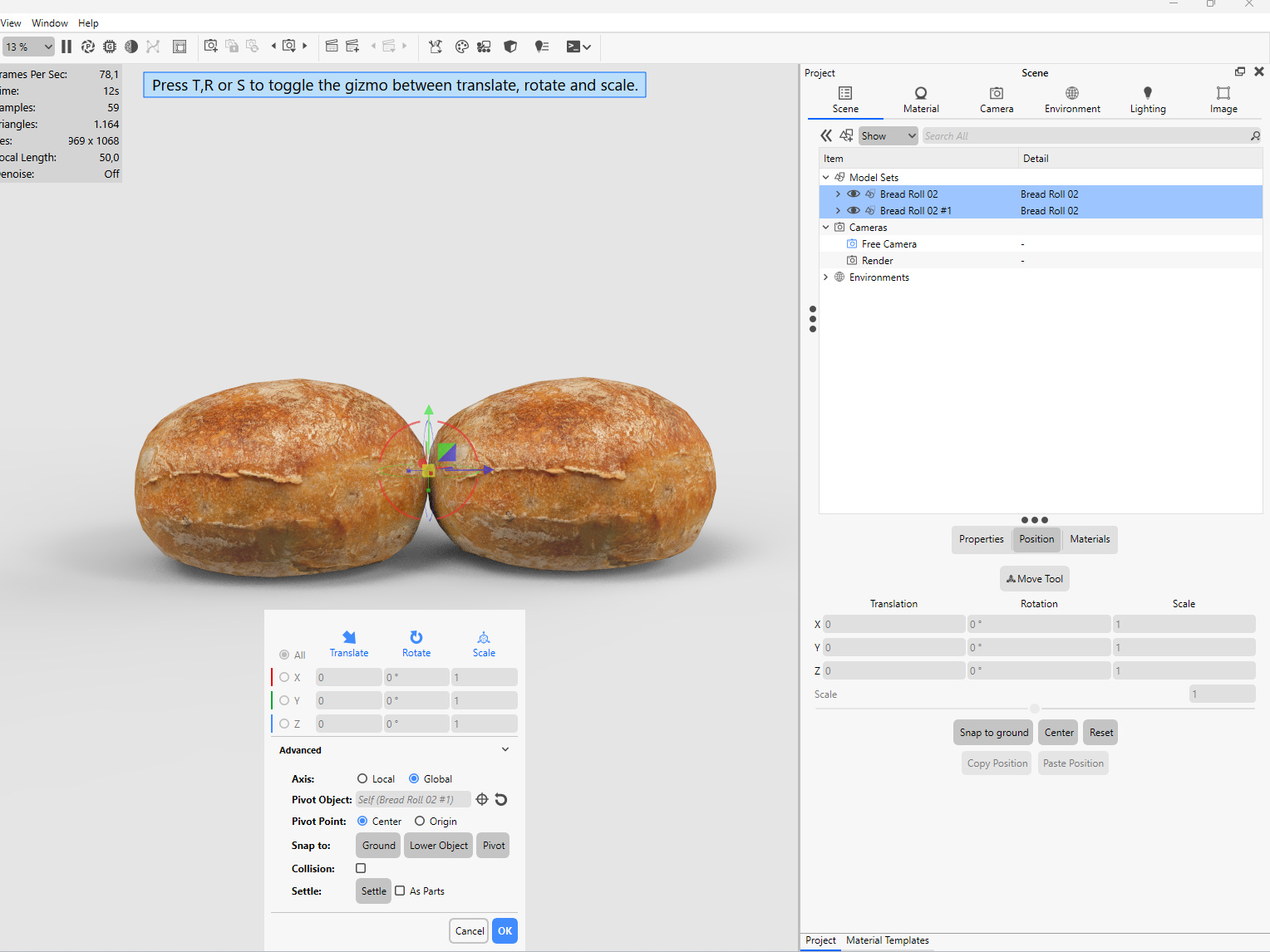

That question caught me curious. So I ran a quick test, with a possible workaround.
  • duplicate the object you want to scale in a direction
  • check the size of the bounding box (in the properties)
  • move the duplicated part(s) with the same distance as the size
    • move the part left, when you want to scale to the right side
  • select both object and the scale origin is on the side, you want
Hope that helps (a bit)

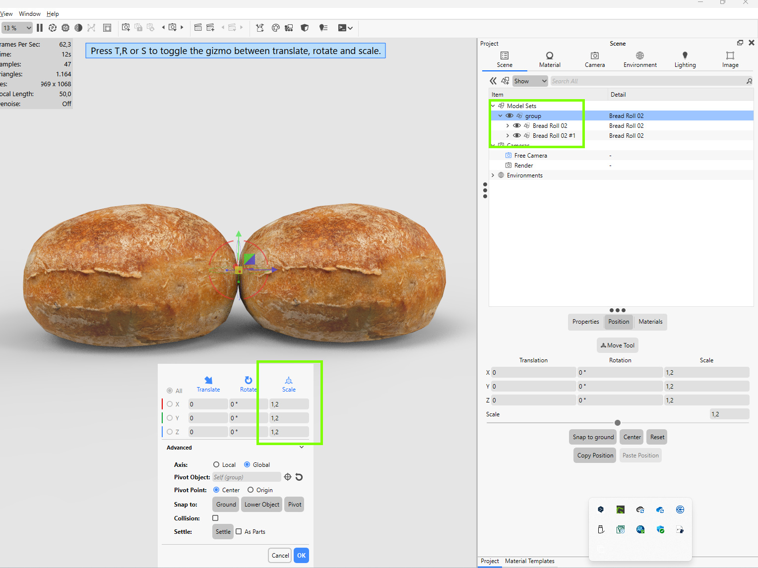

Moving both parts into a group, enables to scale only the group and keep the values
